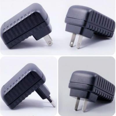

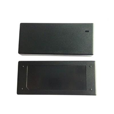

The charger shell of abs shell material produced by Jinkun Technology Co., Ltd.

Charger shell, plastic shell, power supply shell, adapter shell
