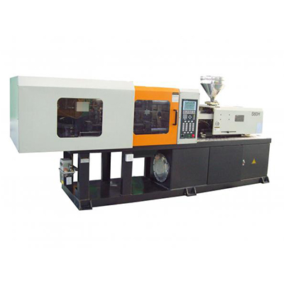

Injection molding machine is also known as injection molding machine or injection machine. It is the main molding equipment for making thermoplastic or thermosetting materials into various shapes of plastic products using plastic molding molds. According to the arrangement of the injection device and the clamping device, the injection molding machine can be divided into vertical, horizontal and vertical-horizontal composite.

General horizontal injection molding machine
